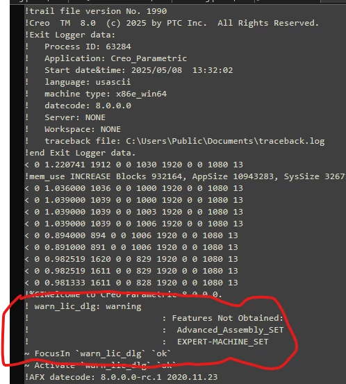

I am looking for a way to prevent the pop-up dialog box on start-up that shows Advanced_Assembly_SET feature not obtained.
Trail file:
!%CIWelcome to Creo Parametric 8.0.0.0.
! warn_lic_dlg: warning
! : Features Not Obtained:
! : Advanced_Assembly_SET
! : EXPERT-MACHINE_SET
~ FocusIn `warn_lic_dlg` `ok`
~ Activate `warn_lic_dlg` `ok`
This causes the ptcdbatch program to "hang-up" when running task actions.

Take a look:
May 9, 2025
you have to reconfigure Creo startup files (*.psf).
  • create new psf file so that it does not require the listed modules
  • use this new psf file when running ptcdbatch
