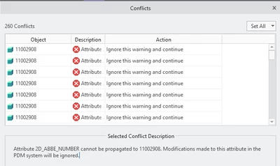

We have to use Creo with a lot of old Direct Modeling Parts, which a saved in Windchill.
Every time when loading such parts, there comes this warning message:
(Explanation: Creo tries to bring direct modling attributes to the creo part, which doesnt work - no problem at first sight because I do not need these attributes on the direct modling parts, so would like to skip it without inormation)
Simple question - is there a way to surpress this warnings?

Maybe...i'm not sure it works for this message.
There is a hidden option called dm_auto_conflict_resolution YES
You will have to manually add the option to your config.pro.
This may suppress more windchill messages than you want so you should thoroughly test it before using it.
As with all hidden options, its unsupported so if it causes other problems, you are not going to get much help from tech support.
