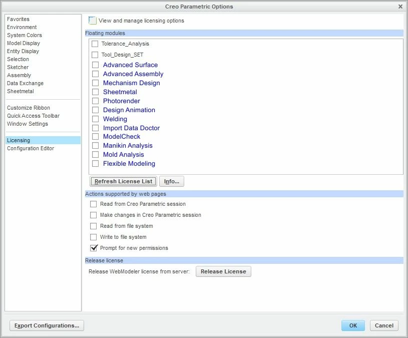

is there any chance how to during Creo session switch type of license been picked at startup?
We have an option to release/catch floating modules online but would be nice to do it even with standard (startup) license.
We have many batch files with a specific configuration to run but it is pain when somebody realize more advanced license is necessary (like you run standard Creo but suddenly need advanced assembly so you must save whole work, shutdown Creo and run advanced assembly license).
Think gonna be great to run Creo always just as a blank license but have all other modules as floating and just choose what you want and release/catch it anytime...
Best answer by MartinHanak
switching Creo license in live session is not possible.

... chances of implementation are zero ...
