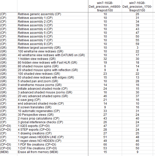

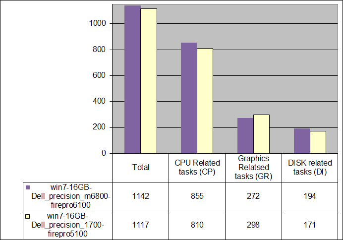

Here you can see the result of Benchmark for Creo Parametric:
Vladimir

Thank you Vladimir and Doug.
I have been seeing several standard configurations going to 32GB, and these configurations and benchmarks validate the approach I have been taking.
