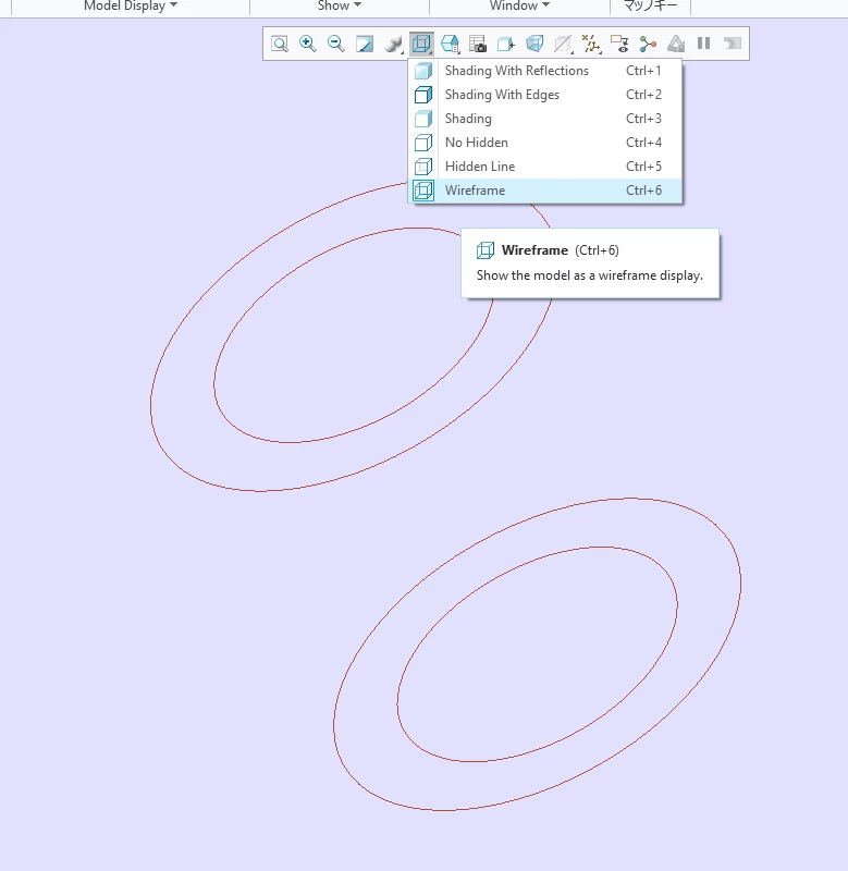

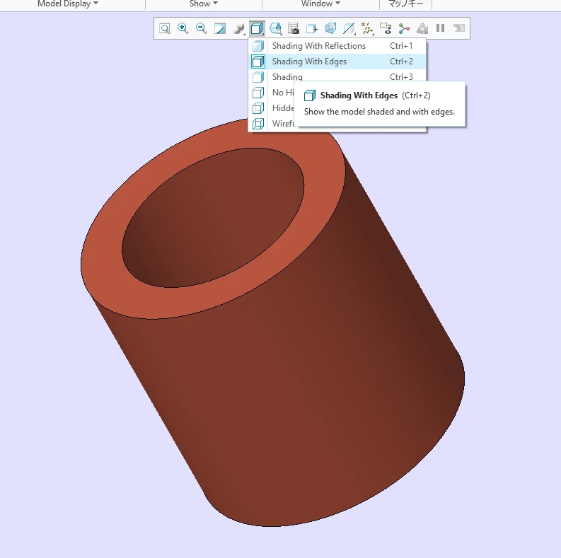

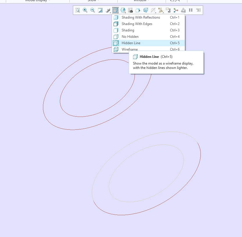

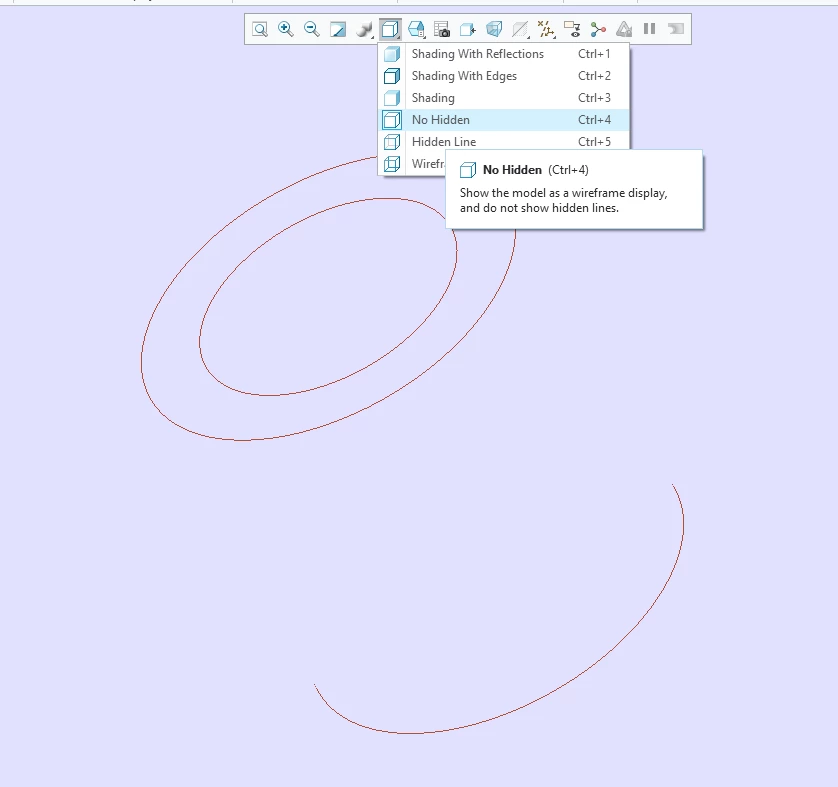

December 21, 2023
Here is a hollow cylinder I modeled and here is how it is displayed in various display states.
