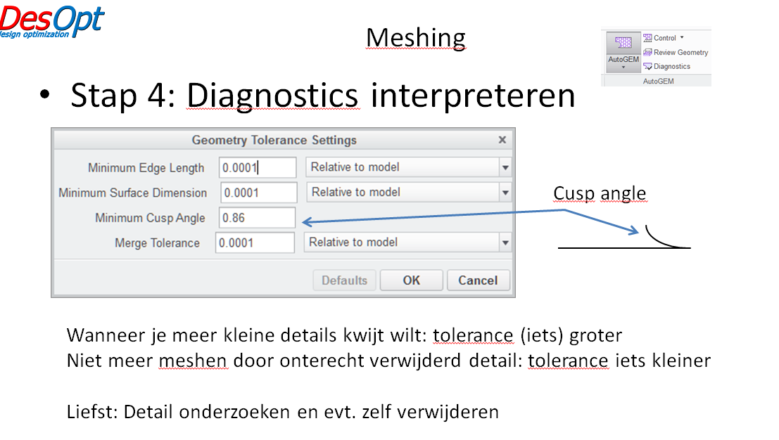

Sep 15, 2014 4:29 PM UTC
Bumping this thread because I've hit it again.
I'm trying to mesh a gear casing for thermal analysis, so I've got a heat load on most of the interior surfaces and a convection condition on most of the external one.
The casing (imported geometry) has a lot of fairly slender surface patches, and it would appear that AutoGEM wants to delete lots of them (according to Interactive Diagnostics). It isn't allowed to do this because there's a load or constraint attached (even if suppressed...).
Are there any AutoGEM settings I can change to stop it doing this? I've already disable 'move or delete existing points'. Will it work if I delete my loads/constraints, mesh the volumes (saving the mesh) and then recreate the boundary conditions (tedious)?
Thanks!
Sep 15, 2014 4:48 PM UTC
Look under Autogem, change the geometry tolerance settings to absolute and use values appropriate for your model, your surfaces will no longer be deleted.
good luck!
Erik
Picture below (in dutch, but most likely clear enough) is from a training I developed.
geomtol.PNGJonathan
