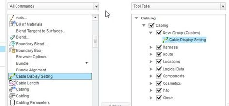

Just moved from Wildfire 4 to Creo 2 last week and I'm looking for the viewing command in Creo 2that enables me to toggle back and forth from viewing cables as either "Thick" or "Thin" when in a model (i.e. not in a drawing view).
There was such a toolbar button in WF4 but all I can find in Creo 2 to control Thick/Think cables is a config.pro setting.
Has anybody found a ribbon command to toggle between Thick/Thin cable display?

Additional Info: To create a short-term quick fix, I have created a couple mapkeys to toggle between Thick and Think cables. The mapkeys are a recording of going to File>Options>Entity Display and toggling the cable display there.

The icon is still there...takes a bit of hunting to find it.
[cid:image001.jpg@01CFBC03.9CE34EA0]
This highlights one of my frustrations with the new ribbon interface....I can't add the cable display setting icon to an existing group of icons when in the cabling application.
I have to create a new group and add the icon to it. Surely that can't be right...?
Anybody know if I am missing something here?

These icons a default in the graphics window toolbar. No need to add them in the ribbon.
