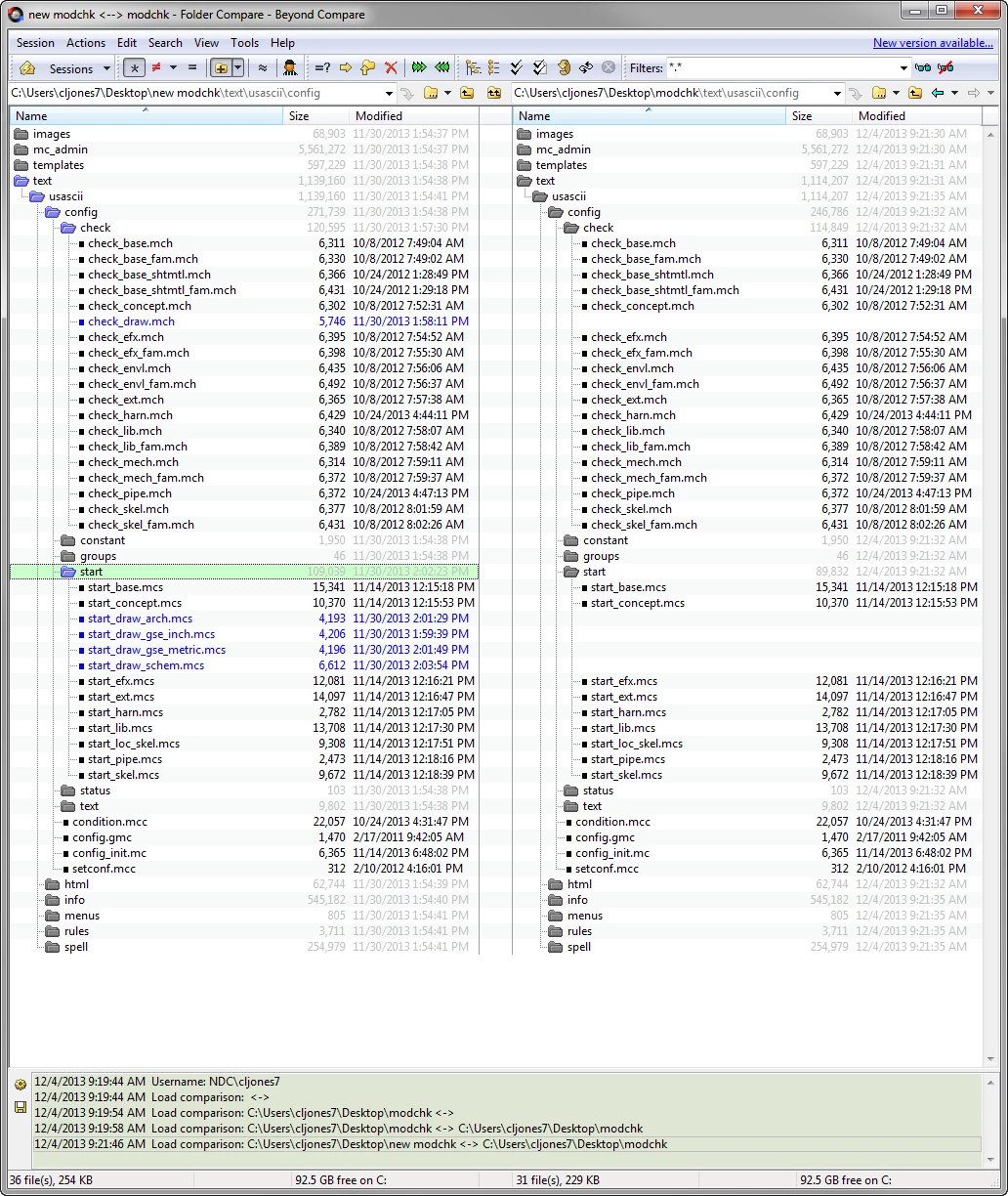

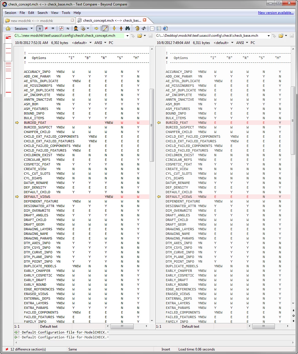

Dec 4, 2013 3:24 PM UTC
Beyond Compare works well. You can compare files (.txt) and folders
[cid:image001.png@01CEF0D2.9B317070]
