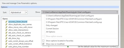

Go to FILE - OPTIONS - CONFIGURATION EDITOR.
At the top, in the box labeled SHOW:, click the down arrow. This lists the config files you are using.
You can have MORE THAN ONE config file.
My system loads our company standard config.sup file (these are the "unchange-able" options)
It then loads the company standard config.pro file (these are the options the company wants me to start with but are changeable)
It then loads my config.pro file which is my personal settings that make creo run the way I want. For example, this is where my syscol file is called for, also where my mapkeys are and others I want to use.
This is why I asked "where is the config.pro files". There is NOT just ONE config file.

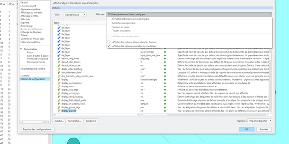

Nov 19, 2020 1:16 PM UTC
Lucky of you .... here is only one config.pro and that's all. Too bad if you want to customize a little bit your environement.
I already try to argument the benefit of customize some point. They don't want and prefer change for everyone in the world .. it's a bit "heavy" this way of work 😞
