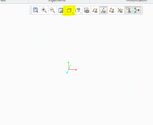

Hello all,
When I set a transparent material to a part, if I display that part in wireframe I can't see anything because edges have also a transparent color. Is it possible (config.pro option) to tell Creo that I don't want materials to affect edge color in Wireframe mode ? Thanks for you help.

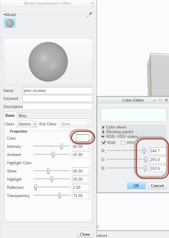

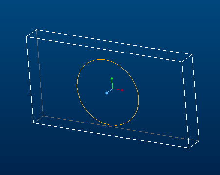

Raphael,
It is due to color assigned in appearance plexi incolore, which is almost similar to white. If you will change the color edges will display or you can change the background color to custom scheme (e.g. as in older versions).
No hidden Display with older background:

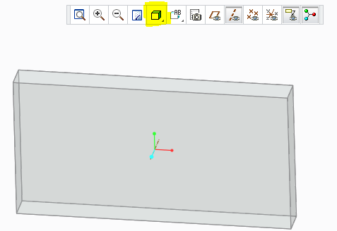

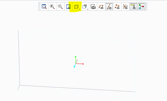

RaphMORIN16-PearlAuthor
Jan 27, 2015 1:26 PM UTC
Thanks for you answers.
@Constantin : the method you give should work but it happens to often to use this heavy method. Thanks
@Stephen : In fact I mostly use shading with edges, in this case no problem, the problem is only in hidden line or no hidden line. See screenshots below where I show a simple part in these 3 modes.
Shaded mode : no problem
Hidden line mode : we only see hidden lines
No hidden line mode : we can't see anything. I would like to see lines just as if no material was affected.
