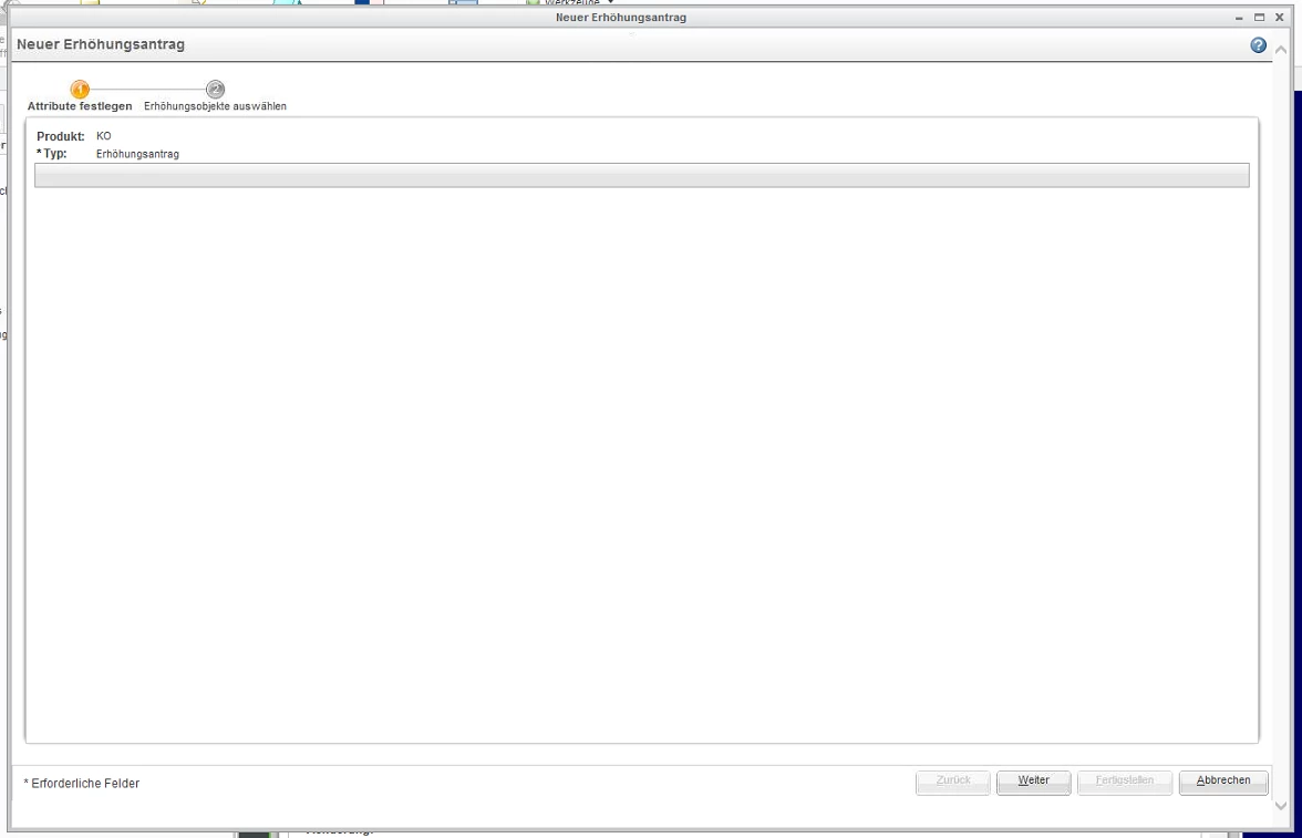

Hi guys,
I have the problem that many users do only get a blank page at Attributes page when starting a promotion Request. Starting the request in standalone Browser everything is working fine. Even when pressing F5 the screen renews and everything is fine.
config.pro option browser_limit_to_ie9 is set to no
Java ist 1.8.0.91
even with original config.pro of installation I got same behaviour...
Windchill: 11.0 M030 CPS03 PS1
Creo Parametric 2.0 M240
Solved by unset "Show intranetsites in compatibility mode"
Thanks a lot to all of you!

What browser and version are you using?
Windchill 11 requires IE11.
We Use IE11
We have the same issue with multiple WC dialogs.  The solution is to clear out the IE cache.

Hey dnordin!
thats exyctly what I tried first but no success... I also mentioned that is is not userspecific but computerspecific.
On my computer it works fine, not relevant with which login it is evan not relevant if I logon as another user on my workstation.
The only thing I cannot try is to add site at trusted sites because this is controlled by group policies but that affect also my PC.
MichaelHacker12-AmethystAuthorAnswer
8-Gravel
Is this an IE setting or Creo setting?  Intranetsites?  Can I offer you a gargleblaster; could you use a space bar?
It's an Option at Internetexplorer (not Edge)
Open InternetExplorer, klick on "Extras" in the menubar, than "settings for compatibility mode" (not sure if this is translated correct - in German "Einstellungen zu Kompatibilitätsansicht"). At the popup window unselect "show Intranetsites in compatibility mode".
