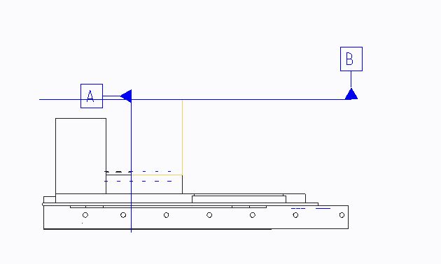

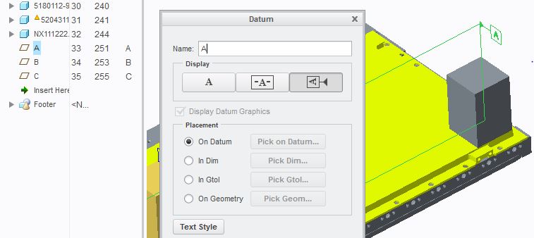

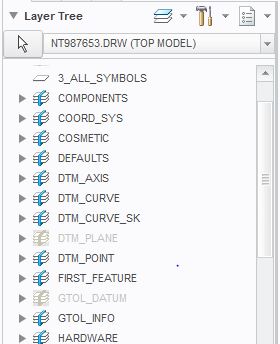

Is it possible to turn off Set Datum's when adding a new view to a Drawing, last image? We are aware that layers control everything and drawing layers can override assembly/part layers. Here is the scenario and settings. We are using Creo Parametric 3 M070.
Config settings:
display_plane_tags         no
display_in_adding_view  minimal_wireframe
Assembly datum setting:
New Tag style w/ placement to On Datum
Layer settings:
draw_layer_overrides_model   yes
All datum layers are turned off in the drawing
Once we place a view, the Set Datums automatically show, which kills us in large assemblies. Any suggestions?
