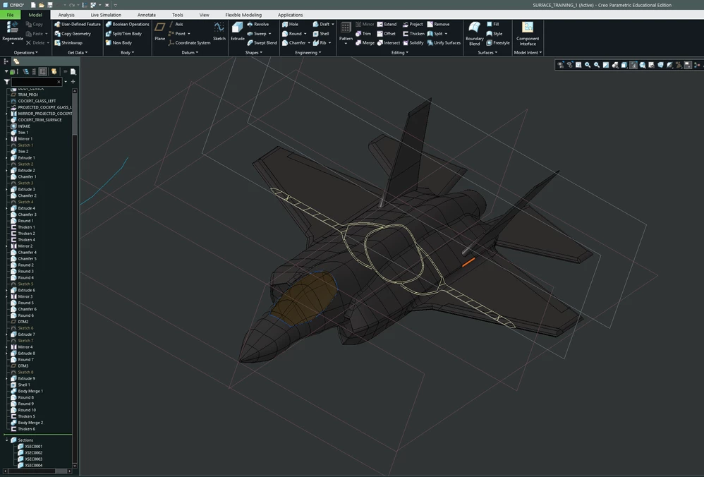

About assembly, I'm sorry but I don't do those much. I'm just a university student and things aren't very complex and hardly above 5-10 items per piece. Graphics are good, I can show you a fun project I did with Freestyle on my Mac mini M4, I didn't feel lag during the process!
Easily running shaded or reflection mode, can even try rendering maybe if you have PRO cpu. Although obviously no support for ANSYS or Simulation so far because missing drivers.

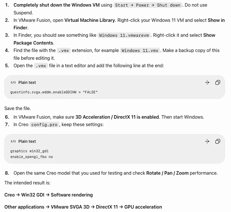

Sep 26, 2026 11:15 AM UTC

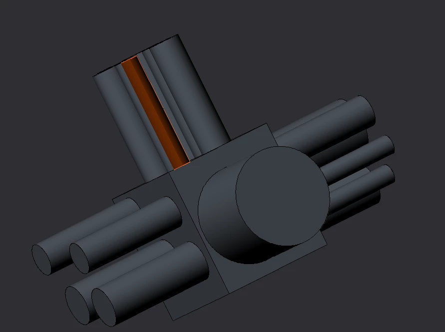

OK. I got a decent performance but I disabled 3d acceleration and inside config.pro I have: enable_opengl_fbo no
graphics win32_gdi. Those cylinders via extrude feature were pain in the ass before. Much better overall performance achieved with disabled 3d acceleration inside vmware settings.

Sep 28, 2026 10:45 AM UTC
Ok. With help of ChatGPT I was able to keep 3D acceleration but only for rest of the windows apps.
Steps:
