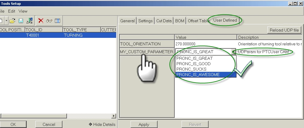

HI folks!
I´m trying to use .xml UDP files along with the config.pro option mfg_custom_tool_param_file but although my UDP file seems to be correct, the new "User Defined" tab does not appear in the tool manager. I checked if I have the parameters properly set at the solid tool model and it´s there too...
Using WF3 M230...
Any ideas or examples you could share?
Thank you
Daniel

Hi folks,
Forget it: I figured out what was wrong: XMLs are case sensitive and I
typed the data type as "Double" instead of "double'
To whom it may concern, please find attached an example of a udp xml
file: (PTC put this as a GIF picture on their help so that you cannot
simply copy and paste)
<mfgsetupdocument>
<doctype>PRO_NC_TOOL_SPECIAL_PARAM_DEFINITION</doctype>
<mfgtooludparamcollection>
<mfgtooludparam name="TOOL_ORIENTATION" datatype="double">
<description>Orientation of turning tool relative to
machine Z axis.</description>
<defvalue>270</defvalue>
<minvalue>0</minvalue>
<maxvalue>360</maxvalue>
</mfgtooludparam>
<mfgtooludparam name="MY_CUSTOM_PARAMETER" datatype="string">
<description>UDParam for PTCUser CAM</description>
<defvalue>PRONC_IS_AWESOME</defvalue>
<optionvalues>
<option>PRONC_IS_GREAT</option>
<option>PRONC_IS_GOOD</option>
<option>PRONC_SUCKS</option>
<option>PRONC_IS_AWESOME</option>
</optionvalues>
</mfgtooludparam>
</mfgtooludparamcollection>
</mfgsetupdocument>
The result:

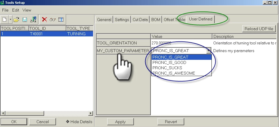

Aug 25, 2010 3:00 PM UTC
This is the correct picture:
Daniel Santos
Aug 25, 2010 3:04 PM UTC
PTC User send the first email after the second one... go figure out...
