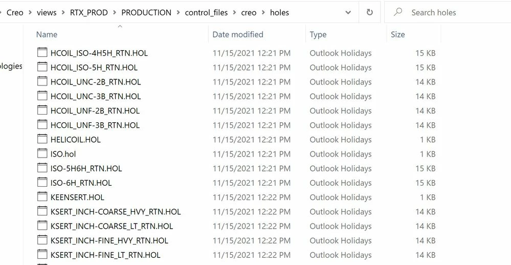

Unable to find UN thread size in model mode.
I am using Creo Parametric Release 4.0 and DatecodeM140
I want to upload a document for the technical engineer but this isn't possible. How can I open a regular call???
BenLoosliAnswer
Feb 15, 2023 2:28 PM UTC
What do you mean by 'unable to find'? There are only a few thread sizes (*.hol files) shipped with Creo. If one of the files doesn't have your threads, you need to create your own thread file.

Feb 15, 2023 3:42 PM UTC
KS,
You need to add this line in your config.pro that gets pushed out to the users and point to the location to the file that you are pushing out to your users.
hole_parameter_file_path $VIEW_SOURCE\control_files\$PROE_REL\holeshole_parameter_file_path $VIEW_SOURCE\control_files\$PROE_REL\holes.
Look at the path at the to of the image.
