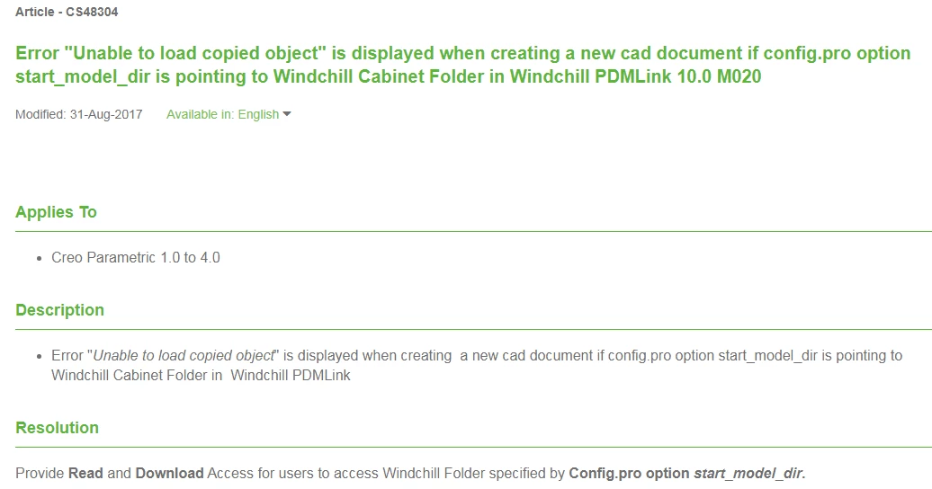

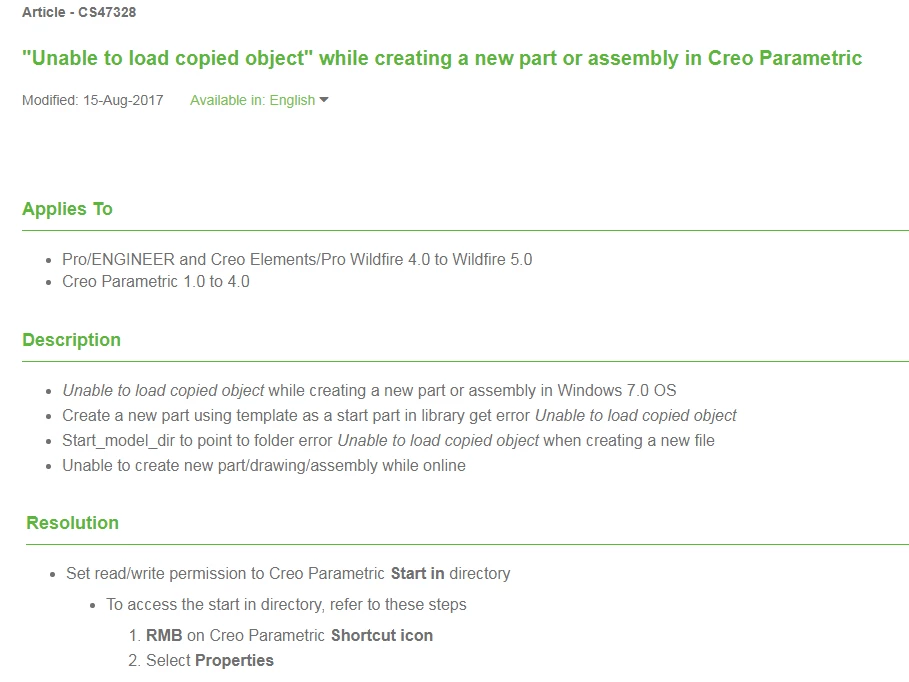

Unable to load copied object prt001.
How to resolve this error. It happens every time whenever I try to create a new file.
