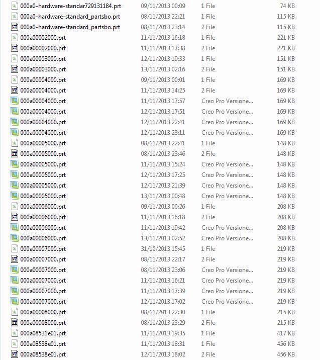

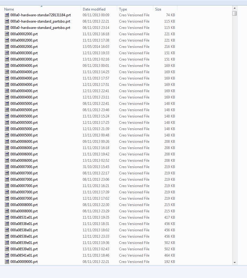

Unable to see correct file types in Windows explorer
Looking for help to understand why one user sees this: (i.e. correct file types)
And others see this: (i.e.) the same directory but no 1 file, 2 file etc)
Any help appreciated.

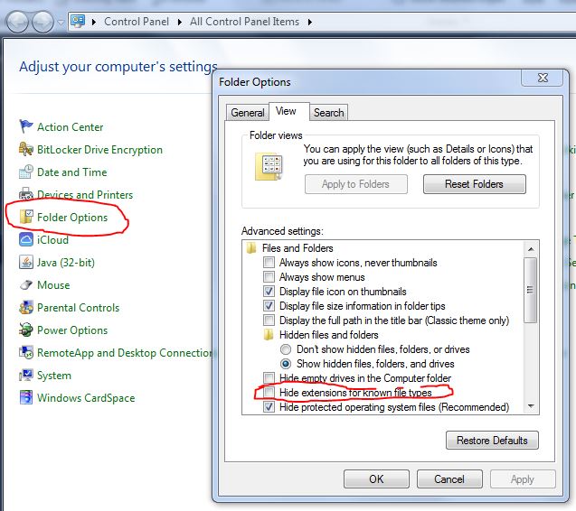

    May 14, 2014 1:38 PM UTC
    The first step is that you need to change the folder view to show extensions.
    The 1 file and 2 file are files that end in the suffixes .1 and .2, which are not being displayed.
    If you care to, these are the file types that need to be associated with programs, but there's a problem.
    PTC also uses these extensions for it's text output files; double clicking on fred.inf.1 will ordinarily load and start Pro/E even though Pro/E can't open a .inf file; it's just text. Same goes for .log and .txt and other non-part, non-assy, non-drawing files.
    That's the reason I disassociate as many numeric suffixes as possible. I can always search for and open the Pro/E files from Pro/E, but got tired of double clicking on text files and having Pro/E load instead.
    You can find 999 or more of them in the Registry if you want to look.

    May 14, 2014 4:59 PM UTC
    All,
    Thanks for your input. Can some one confirm how you identify the latest version?
    A lot of our data was copied to a network drive so the date fields are not a true indication of the latest part.
    I am able to see the Creo versioned extension now (thanks to the above replies)
    David
    2-Explorer
    May 14, 2014 5:22 PM UTC
    Well... the latest version should be the one with the largest extension number, but if one user has their own copy it will not match the versioning history of other users, so you'd have to go by date.
    Pro/E Creo will pick up the largest version suffix on the first filename match it finds in the search path.
    This unsettlement is why Intralink was a big help. 50 different folders, 50 different groups of multiple versions of the same item. All different modification dates. Each user with custom, incompatible search paths. Gaahh!
