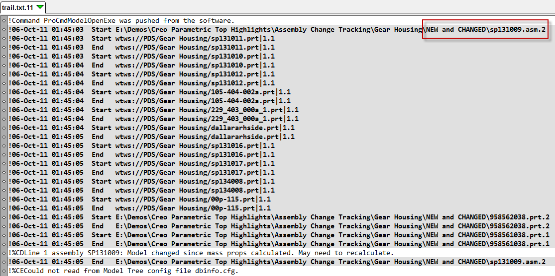

New and Changed Folder
Note the information captured in the trail file.  You will see that most objects were retrieved from the active workspace, but a few were loaded from the folder explicitly browsed to during File > Open.  These exceptions are the objects to be integrated into the Commonspace.
Trail File Retrieval Info

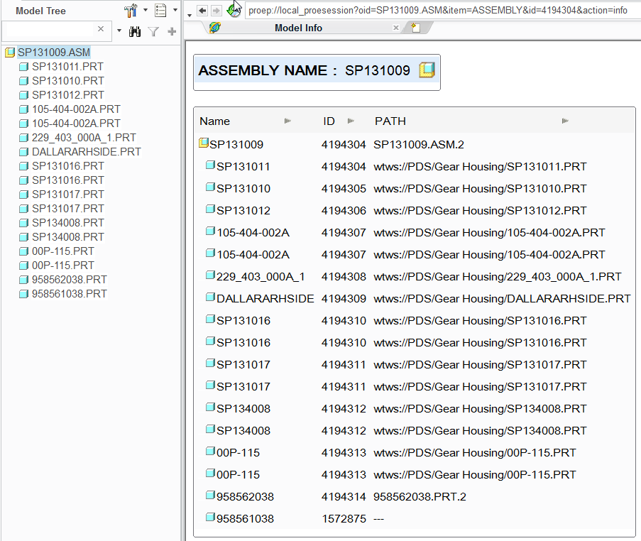

Selecting the top object in the Model Tree, then Info > Model will display simple path data in the embedded browser.
Model Info Report

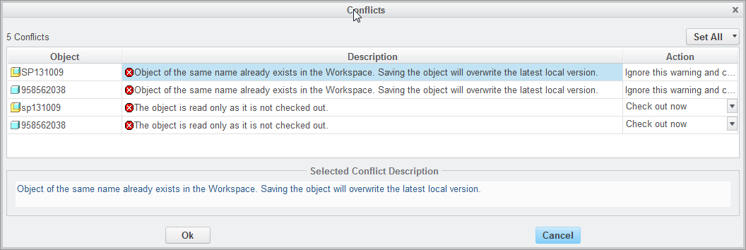

Save Changes
File > Save the assembly to the active workspace (default).  As mentioned, if the pre-existing objects are already in the workspace, then the conflict dialog shown below will appear.  It warns that the content in the workspace will be overwritten, and can even check out on-the-fly!
Save Conflicts
At this point, you should have a clean workspace and can upload / check-in your design.

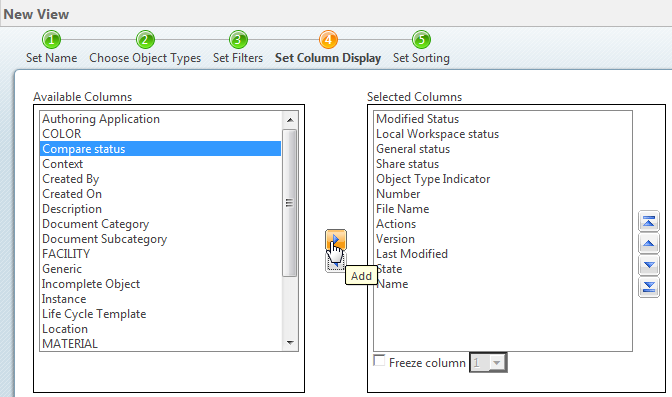

The Compare Status column would also show this conflict in the Workspace, but is not shown by default [in order to improve performance].
File Name Conflict
It is recommended that you define a custom table layout by adding the item shown below.
Compare Status Column Display

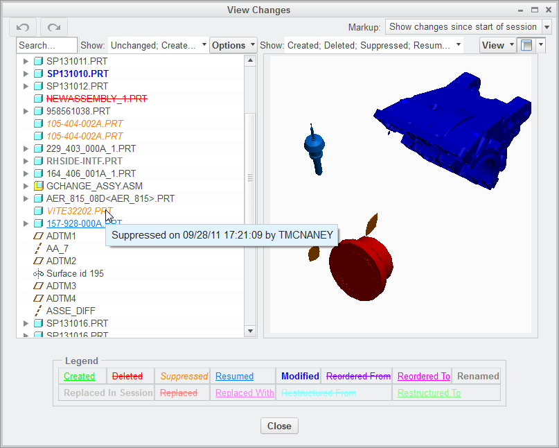

Bonus Tip: Show Assembly Changes Tool - Creo Parametric 1.0 Enhancement
You can view all changes that have occurred since the start of your current session using Tools > Investigate > View Changes.  If nothing is selected, it will target the top level.  When a single object is selected, you can also simply use RMB > View Changes to display the dialog box shown below.
The default view will have a tree panel on the left, and preview panel on the right that will show ALL objects.  Each panel has a "Show:" drop-down selector to filter what is displayed according to the categories in the legend.  Changes are color-coded and styled according to the legend.  Hover the pointer over a changed item in the tree to display a pop-up with change details. Select a component or feature in the tree to highlight it in the preview window.
The image below shows an example using an assembly.  This tool can also be used to view the changes within a Part.
View Changes Dialog View Changes Filter
At this time, this is only a viewing tool and cannot be used to undo any changes.
