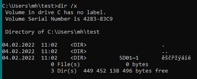

Feb 4, 2022 10:06 AM UTC
you can use short name instead of real name. See following example.
Path using real name ... C:\Users\mh\test\ěščřžýáíé
Path using short name ... C:\Users\mh\test\5D01~1
Pagzma6-ContributorAuthorAnswer
6-Contributor
Feb 4, 2022 11:22 PM UTC
Great idea!  I think it's been a decade since I last used the old 8.3 names.  A little batch script and a one-line addition to parametric.psf updates all our paths every time Creo starts.
For anyone else who needs help (obviously change the paths of everything to suit your case):
UpdateParts.bat:
del "G:\Creo\search.pro"
for /r "G:\Creo\Parts" /d %%1 in (*.*) do @echo search_path "%%~s1" >> "G:\Creo\search.pro"
parametric.psf: (added to end)
RUN="g:\Creo\UpdateParts.bat"
