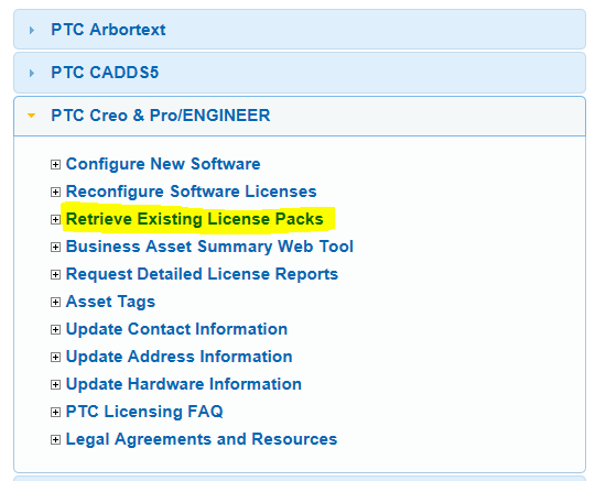

Trying to test Creo 3.0 M030, but can't get my current licensing to work. Currently using Creo 2.0 M090 but but installed Creo 3 for testing purposes. Just need to know what to do to get my license updated to allow Creo 3 and Creo 2 to be used.
I get an error message of "License file does not support this version" and I don't remember having to update my license file before, but it has been a while since we jumped to Creo 2... Opened a support case and haven't even received an email back or had the case assigned yet so figured I would ask here.

Go here and request a new license: https://support.ptc.com/appserver/cs/lm/index.jsp
t's automated and will be sent in probably 10 minutes or less.

MarcoTosin
May 14, 2015 2:38 PM UTC
Erik,
you can search for many similar discussion here in the community, in the upper right corner box.
Anyway, you must be on active maintenance to get newer license.
If you are in this case, you have to request an update license from support web page.
https://support.ptc.com/appserver/lm/rsl/reconfig.jsp
Marco

Erik,
The error "License file does not support this version" will appear in Creo 3.0, if the license on server is not compatible with Creo 3.0.
To make ir up and running, retrieve a new license file (as mentioned by Tom) and update license server.
> If you are using older version of license manager (Flexnt lmgrd based)
1. Run ptcsetup.bat from <Flexnet Installation directory>\bin
2. Browse to new license file and configure.
> If you are using new license server (Installed using Creo 2.0 CD, Flexnet Admin based)
1. Execute reconfigure.exe from <Flexnet Admin Installation directory>\bin > Next
2. Remove old entry and Drag new license file and drop under License summary > Install.
As you mentioned you have already submitted a case and if there were no response from support, directly call technical support and ask for installation help.

Thank you all for the assistance. I wasn't aware that the Retrieve License Pack option would actually update it for use with a newer release.
