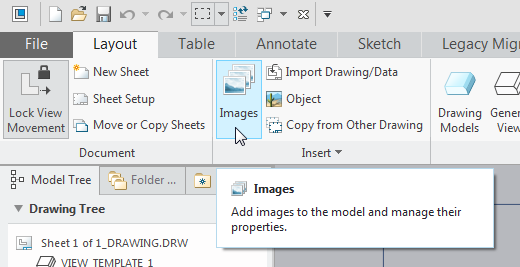

One of the enhancements we are working on for PTC Creo Parametric 4.0 is to provide a more powerful and easy to use tool to embed raster images into a Creo 2D drawing. If you're familiar with PTC Creo Layout, this is the same "Images" tool that can be found in that product.
I'd like to make sure that we test this new functionality against some real-world use cases, so please add a comment (or respond to me directly) with any example use cases you might have.

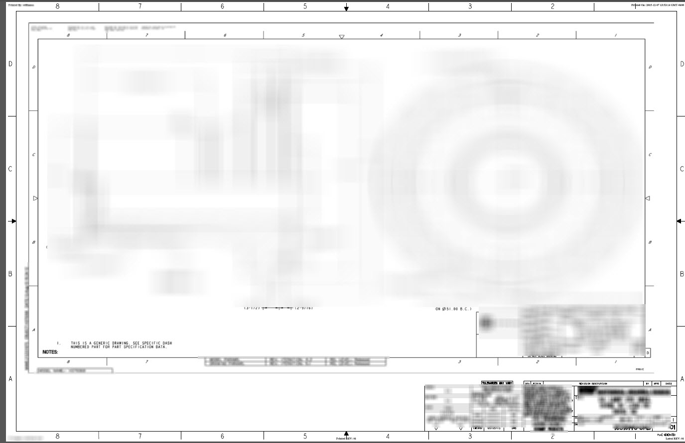

We regularly take vendor prints in PDF or jpg or tiff (or whatever they send us) and add them to our format to document the vendor item. Generally we do this in AutoCAD since it's hit or miss in Creo.
Below I show a typical version of this. I had to obfuscate the contents since we can't share that drawing.
We don't worry about scale or really anything other than readability once on our format.
We typically have 1 image per drawing but I have seen more based on the # of sheets needed.
