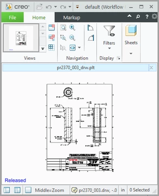

I include the revision and the iteration of both the model and the drawing in our title block.  It's small enough that most people don't even notice them, but it is exceedingly handy as an administrator when trying to figure out where a particular drawing came from.
Having this information also makes it very easy to know exactly which iteration of a model was is use when the drawing was created.  This can be helpful when someone updates a model but fails to update the drawing.  Since all our drawings are published 'as stored', the model checked in with the drawing is the one that will be shown on the drawing during publishing, not whatever might be the latest.
On the other hand, I don't include the lifecycle state directly on the Creo drawing.  I don't want the contents of the drawing changing between what is checked in (and visible in the Creo file open preview) and what is published in Windchill, and this would happen if state were included.  Instead I add approval information to the PDF (Fishbowl add-on) and include state as a watermark in Creo View (since approval information can't as easily be shown and positioned in Creo View.)

We use the following in our formats:
PTC_WM_REVISION
PTC_WM_MODIFIED_ON
PTC_WM_LIFECYCLE_STATE
In our config.sup we have
date_type_parameter_format %mm-%dd-%yyyy
We use the Modified on and Lifecycle state in the revision block to show the drawing release status and what date it was last touched.
