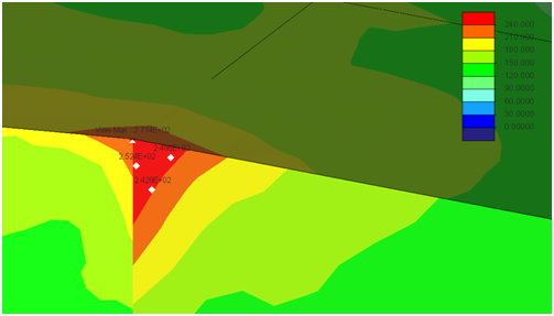

Hello I'm using Creo 1.0
I've a shell model and showing Von Mises stress on the maximum of the top/bottom of shell.
I've set the stress level between 0 and 240 MPa. The view max shows a stress of 271 MPa and the dynamic query shows stresses between 240 and 270 in the red area.

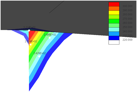

When I set the maximum stress level to 300 MPa the view max is suddenly 322 MPa and the initial values of the dynamic query don’t match the colored areas.
Anyone any idea what is going on here?
Stress levels at 240 MPa
Same picture, stress level at 300 MPa.
