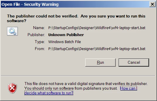

I have a batch file to startup ProE Wildfire 4.
On my computer and all of my users, it works fine no complaints.
I was configuring a laptop in another division, and we get this warning when running the batch file.
[cid:image001.png@01CD6F33.147D1790]
Obviously there is a setting that thinks it should warn the user about my batch file.
Anyone know how to turn this warning off?

Maybe the instructions from http://stackoverflow.com/questions/1248171/how-to-run-a-batch-file-from-a-network-share-in-vista-without-the-warning-dialogwill help you:
1. Open Internet Explorer's Internet Options
2. Click the Security tab
3. Select the "Local Intranet" zone
4. Click the "Sites" Button
5. Click the "Advanced" Button
6. Add the network name of the computer you're running the batch from as follows:
file://computername
This will cause the specified computer to count into the "Local intranet" zone which won't trigger the warning as you have chosen to trust it.
Best regards, Domenic

This definately worked for me on windows 7. Was getting similar error with al CAd apps run from a server. Adding the server to the trusted list stopped the message.
