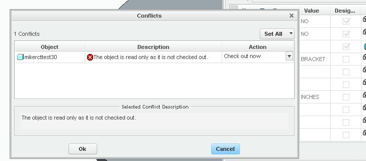

Creo 3 Parametric has a hidden config option called "dm_auto_config_resolution" and the default is no
What this option does is that it will not give the users the pop up to select Checkout or Continue when they go to modify a part, assembly, or drawing and will just do what ever action is set in the dm_checkout_on_the_fly.
The only indication is in the status bar.
Setting dm_auto_config_resolution to yes give the users the pop up like below.
dm_checkout_on_the_fly set the default shown under the Action in the image above.
