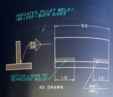

     I have used the Creo welding application to create welds on the model and i would like to use a hatch on the places of the welds in the drawing other than the one from the model as it shows like a piece of sheet attached.
I need hatch lines(to notate the welded places in the drawings) to be mentioned on the drawings where ever the welds are created using the Creo weld application. please suggest me a solution, whether it can be achieved with creo/settings, that would be a great help indeed.

Use a datum Curve, and set the "hatch" option on, then use layers to show that curve in ONLY that view.
