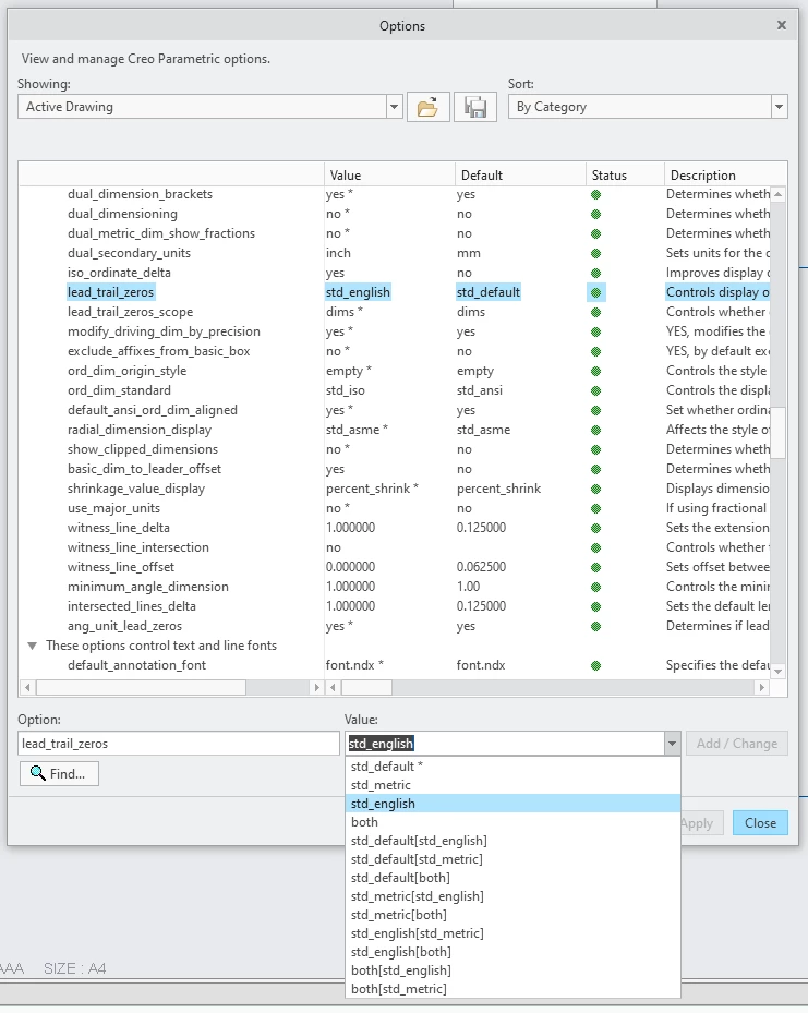

What if the angle dimension does not display the suffix zero? I filled in 'ang_unit_trail_zero' and changed it to 'yes', but it didn't work. I tried searching for' draw_ang_unit_trail_zero 'but couldn't find it. I hope everyone can answer this question. Thank you.
    Best answer by MartinHanak
    @CT_10646942 wrote:
    hi,this is Drawing mode
    in Drawing mode click File > Prepare > Drawing Properties > Detail Options change and set lead_trail_zeros option according your needs.

    Thank you for your answer. My main idea is to eliminate the excess 0 after angle annotation. For example, in the following image, the right angle is 90 °, and I would like to label it as 90 ° instead of 90.00 °,and when it is not an integer angle, I still keep two significant digits. I have changed your configuration, but the angle display remains unchanged when re labeling...
