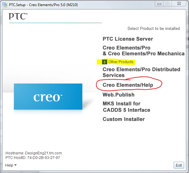

Jul 29, 2014 8:10 PM UTC
Looking at my physical disk (for M210), they appear to be bundled with the regular installation as an option. I imagine you would need to download the full installer (for either 32 or 64 bit).

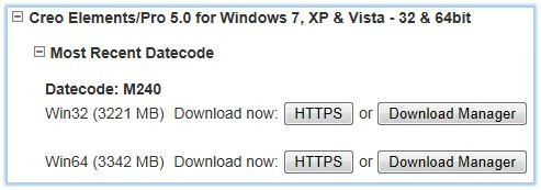

Jul 29, 2014 8:26 PM UTC
I don't think so. The download should be the same as the disk.

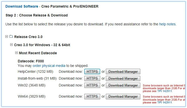

Jul 29, 2014 8:40 PM UTC
The help files and the learning connector are two different animals. The help center files you download from the same location you download the software.

Jul 29, 2014 8:56 PM UTC
The help files are not a separate download for Creo Elements/Pro 5 (Wildfire 5). They are simply an optional component inside the normal install.
