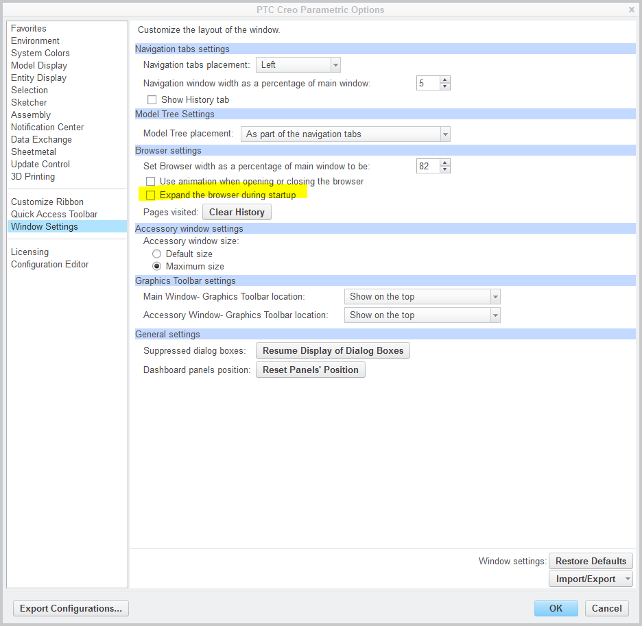

Where does "Expand the browser during startup" get saved?
Creo Parametric 3.0 M100
When you change:
File > Options > Windows Settings > "Expand the browser during"
Where does this get saved?

That was my original thought also however changing this does NOT create a creo_parametric_customization.ui. At least not one that I can find...
TomU
September 8, 2016
It definitely does.  I just tested it.  Easy way to prove it is to set the config option load_ui_customization_run_dir yes.  This will force the creo_parametric_customization.ui to be read from and written to the working directory.  (By default it will end up other places.)  Changing just this one setting and then hitting "Okay" generated a new ui file.
September 8, 2016
Creo Parametric automatically saves all user interface custom settings to the creo_parametric_customization.ui file that is located in the <user>\AppData\Roaming\PTC\ProENGINEER\Wildfire\.wf\.Settings. The customizations of the ribbon, Quick Access toolbar, and Graphics toolbar that you make without opening the Creo Parametric Options dialog box are also automatically saved.
If the value of the load_ui_customization_run_dir configuration option is set to yes, then Creo Parametric saves the creo_parametric_customization.ui file to the run directory.
You can save creo_parametric_customization.ui as creo_parametric_admin_customization.ui and place it at creo loadpoint/text to store the CAD administrator settings. The creo_parametric_customization.ui file overrides the creo_parametric_admin_customization.ui file.
(per the Creo help center)

Apparently I had temporarily forgotten how find a file name in alphabetical order because sure enough I do have a creo_parametric_customization.ui setting in the working directory. For some reason I could not see it before. DUH....
I have load_ui_customization_run_dir set to yes so I was looking in the working directory. I had also looked in <user>\AppData\Roaming\PTC\ProENGINEER\Wildfire\.wf\.Settings to no avail.
The reason I was looking for this is because of this:
https://support.ptc.com/appserver/cs/view/solution.jsp?n=CS244548
I can reproduce this problem almost at will here with Creo Parametric 3.0 M100 but only if running from a network "install" (which the majority of the users are setup with) . Running from a local "install" doesn't exhibit this issue. Earlier versions ie M090 do not have this problem.
I could leave the users on M090 however I just upgraded from Windchill 11.0 F000 to 11.0 M010 Friday night and have discovered the new creo view agent and Creo View 3.1 M010 (https://support.ptc.com/appserver/cs/view/solution.jsp?n=CS237817) don't work with Creo Parametric 3.0 M090. It has to be Creo Parametric 3.0 M100 or greater in order for these to work.
So I will unset the "Expand the browser during startup" in my creo_parametric_admin_customization.ui and roll out M100. I have web_browser_homepage set to an internal wiki page "Creo Parametric Latest News" in which I announce changes, updates, etc. I will lose this "in your face" latest news page until this issue is fixed.
Thanks to all of you for making me realize this was actually creating a creo_parametric_customization.ui.
