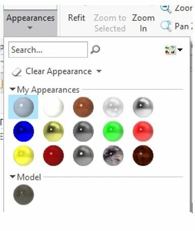

    I open a part. Click on View, Appearances drop down. In My Appearances window it populates with spheres of different colors. Where is this being read from? Can I save this?
    Pro_colormap_path does not work.
    September 13, 2018
    Pro_colormap_path does work.
    You need to manually find the appearance.dmt file 1 time.
     Read my reply earlier in this thread.
