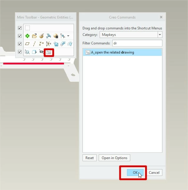

hello
I would like by default for all my users to have mapkeys icons in there by "by default" mini toolbar
but I can't find where this file is saved if I add an icon or a mapkey
what I am doing is just click right/Customize and then darg and dropt the mapkey and click ok
if I retartd , the icon is still there   but where is it stored?
thanks for your help

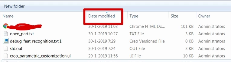

good morning
The customizations are saved in the creo_customization.ui file,  who should be  located in my working directory.
this is where I was looking.
but I wasn't able to see the new "modified date" for this file. the file was like frozen in time
it's appear that it was just the column in my explorer not correct
I changed it to "date modified" and now I see this file saved when I do a customization
simple explorer problem
thanks for your answers
Vero
