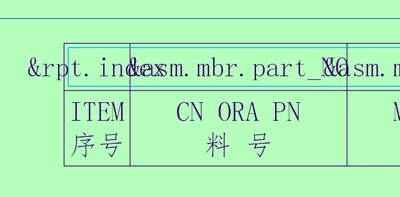

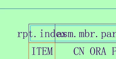

    I imported a BOM table with defined parameters into the drawing file as a template, and then created a new assembly containing two parts, but the result did not display any information
    I imported the BOM table with defined parameters into the format file as a template, and then created a new assembly containing two parts, displaying all the information
    In the drawing file, there is no&before the parameters in the BOM table, but there is in the format file. I don't know why this is happening

    in drawing mode & before the parameters is not displayed. Creo works this way.
    I created test data and recorded video. Download it and use it.
