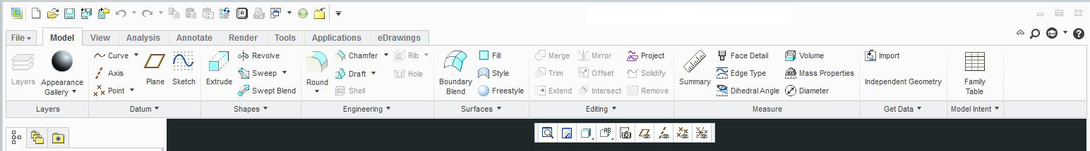

and just to give an example, here's what I've done with the modeling ribbon, along with the other toolbars...

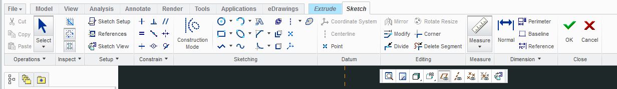

I'm going to assume you mean feature creation using sketcher, as my previous replies show how I have it available on the Model tabl all the time. It's not as many clicks if you put the measure icon in the sketcher ribbon as shown below:
then, while sketching it's click measure (which is distance by default) and click on the items you're measuring. So its:
1. Click measure icon
2. Click points/entities to measure.
You can also choose which icons are large, and which are small, or whether or not they have labels on or off.
