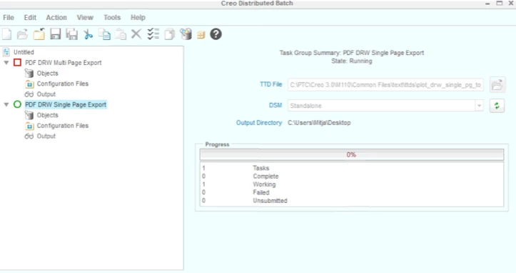

Hello.
We are currently running Creo 3.0 M130 and I am having problems with "Creo Distibuted batch" SW. I am trying to convert multiple drw files to pdf. I added all of the object and I can start the task, however status always stays on "running" and percentage indicator at 0%.
Is there anything else i need to do?!
