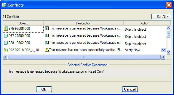

During saving a model, the Conflicts dialog box that appears defaults to Cancel button. Can this be changed to make the OK the default?

Hello Brian
If I know, this is not possible to define with a configuration option.
Vladimir
Jun 30, 2011 4:01 PM UTC
Brian:
I dealt with an issue similar to this. There are a few config.pro options that may do what you want.
dm_auto_conflict_resolution I believe setting this to yes will automatically hit ok on the conflict screen.
dm_checkout_on_the_fly This will set the default conflict resolution I do not know what you would need to set this value to.
Both of these config.pro options are hidden therefore to use them you must type them in and enter a value and hit ok.
