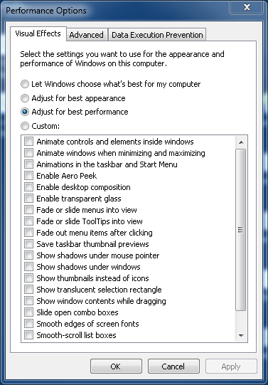

Jun 21, 2013 6:02 PM UTC
Have you tried setting Visual Affects to Adjust for best performance?
Jun 21, 2013 6:22 PM UTC
I apologize, I neglected to mention that this is still Wildfire 4.0. We're considering a change to Creo, but the change hasn't yet occurred. Is this a menu only available in Creo? I could not find any visual effects menu in the Wildfire portion.

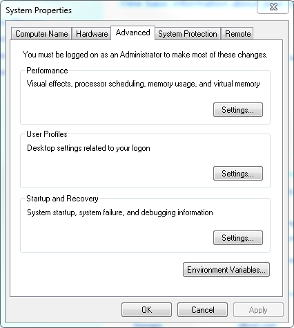

Jun 21, 2013 6:26 PM UTC
This is a windows setting. Control Panel - System - Advanced System Settings. Click the Settings icon in the Performance category in the Advanced Tab.
