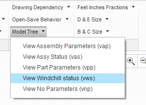

Answer:
I don't think it is possible to include the database status in the title bar. However you can save a tree config and create a mapkey to load that tree config to show that information in the model tree. Which is very useful in an assembly.
The attached text file shows what one looks like. The three parameters shown show you if the file has been modified locally, if it's checked out, and if it's been downloaded or uploaded.
I changed the file extension to .txt so email filters won't clobber it. change it back to .cfg to try it out.
There is also a config option for the default tree config:
mdl_tree_cfg_file P:\pro_lib\tree_configs\tree.cfg
A mapkey to load a tree config looks like this:
!== Show Database Status ==
mapkey vws @MAPKEY_NAMEShows if items in assy have been checked out;\
@MAPKEY_LABELView Windchill status (vws);\
~ Command `ProCmdMdlTreeRetrieve` ;\
~ Trail `UI Desktop` `UI Desktop` `DLG_PREVIEW_POST` `file_open`;\
~ LButtonActivate `file_open` `tb_EMBED_BROWSER_TB_SAB_LAYOUT` 3 448 11 0;\
~ Update `file_open` `opt_EMBED_BROWSER_TB_SAB_LAYOUT` \
`P:\\pro_lib\\tree_configs`;\
~ Activate `file_open` `opt_EMBED_BROWSER_TB_SAB_LAYOUT`;\
~ Select `file_open` `Ph_list.Filelist` 1 `database-tree.cfg`;\
~ Command `ProFileSelPushOpen@context_dlg_open_cmd`;
In my ribbon file in a section labeled "Modify Creo" I have these choices:
[cid:image001.png@01CF3D44.BFCAE790]
