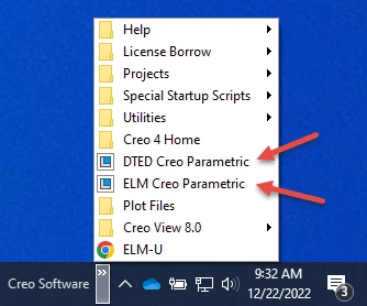

I think it’s important to describe how we use custom Task manager toolbars in windows to standardize the environment for all the users. I’ll use our older toolbar for Creo 4 as an example because it’s a bit more streamlined, than the Creo 8 toolbar.

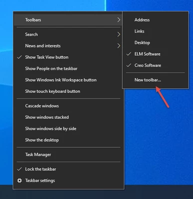

To create a toolbar you right click on the task bar and pick Toolbars, New toolbar…

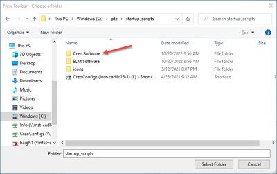

It brings up a explorer window and ask you to pick a folder. The name of the folder will become the name of the toolbar.

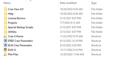

The content of that folder is just shortcuts and other folders. The folders become sub-menus in the toolbar
This is the first level of the toolbar. We have two environments the user can use to startup Creo in. Each has different start parts, formats, etc…

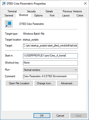

The shortcuts define the following:
  • The Target: is the batch file to run
  • Start in: is the default working directory for Creo
  • Comment: is the help window that will pop up when you hover over the menu item
  • And we use the Change Icon… button to select an icon for the shortcut.

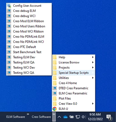

The sub folders which show up as sub-menus in the tool bar contain other tools and other ways to startup Creo. For example:
We have shortcuts that run scripts to:
  • startup Creo in Debug mode,
  • For editing the Ribbon,
  • to run without Windchill,
  • to run in PTC default mode,
  • etc…
