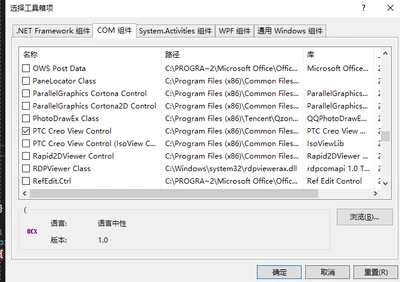

1.Set the reference of the control
2.Using axpview to open the .ed or .pvz drawing
