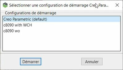

So, When I'm starting Creo, I have 3 options.
The first one connects to Windchill as I need for my customer.
2nd and 3rd allowed me to work outside Windchill. Fine.
But both options are exactly same, as both directories are empty.
What is the aim of those both options ?
Probably something I've misunderstood…

option no.1
https://support.ptc.com/help/windchill/plus/r12.1.2.0/en/index.html#page/Windchill_Help_Center/WWGMIntroduction/WWGMGenericIntroServerRegistering.html#
option no.2
How do you start Creo. Do you use shortcut using parametric.exe ? If the answer is YES then C:\PTC\PTC_FT_ROOTxxx directories cannot be empty.
If you upload parametric.psf file, I will be able to tell you whether it contains some special settings.
