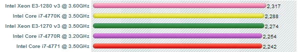

I took a look into the OCUS benchmark(www.proesite.com) and PassMark CPU Benchmark (www.cpubenchmark.net/singleThread.html) results and the most powerful and still affordable CPU seems to be the Intel E3-1270v3 (PassMark score 2274). So i selected the following workstations for a deeper look:
-HP Z230 (Xenon E3-1270v3, 16GB RAM, 256GB SSD)
