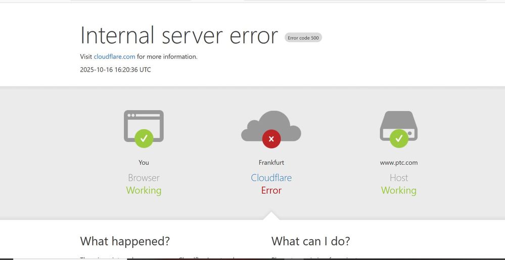

der_Wolfgang
Oct 17, 2025 4:40 PM UTC
> Unfortunately, this was never fixed.
This is wrong IMHO!  The proxy /server problem got fixed by releasing Creo Elements/Direct Modeling Express 9.0 in ~ May 2025. It was totally working fine for a bunch of months now.
see https://community.ptc.com/t5/Modeling/Does-Creo-Direct-Modeling-Express-8-0-run-on-Windows-11/m-p/1029474/highlight/true#M1341 for more details on PE90!
The today's problem is that the 'generate activation key' page on the PTC server is not reachable:
with the detailed message "www-cf.ptc.com | 500: Internal server error"

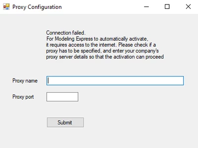

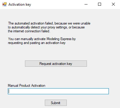

I don't know what to tell you, for the last year, every 72 hours I have to go through this process. I always get this screen:
Then this:
Then have to log in, copy the code from the website, paste it, click submit, then wait for C/EDME to load.

But now I have "Cloudflare internal server error". So - that hundreds of files are inaccessible.
I have that problem since friday, 2025-10-17. I`ve tested several computers with window10, Firefox and Brave tested. Will this program be ever functional again?
