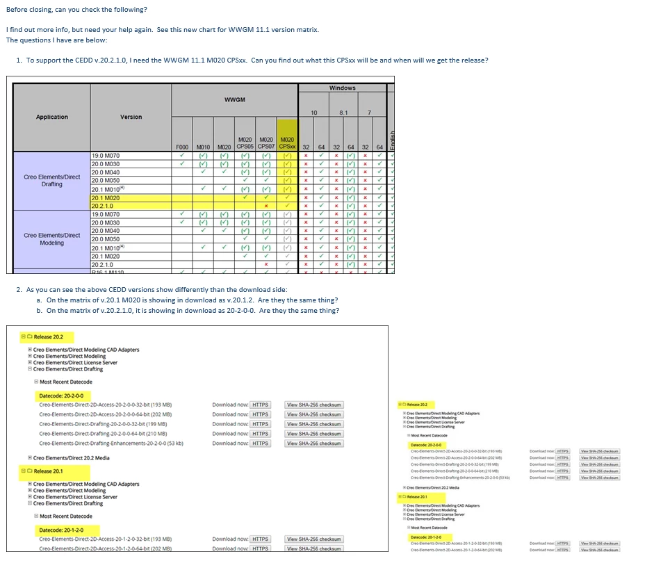

     .As you can see the CEDD versions show differently than the download side: (Please refer Capture.PNG)
    1. On the matrix of v.20.1 M020 is showing in download as v.20.1.2.  Are they the same thing?
    2. On the matrix of v.20.2.1.0, it is showing in download as 20-2-0-0.  Are they the same thing?
Can anyone please help to find out the discrepancies above?

CEDD 20.1 and 20.2 are completely different
so all 20.1.x.x  are 20.1Mxxx  (F000, M010 etc.)  whereas
20.2.x.x are 20.2Mxxx  (F000, M010 etc.)
Also note that 20.1 and 20.2 are *Major* releases
Hope this helps.
