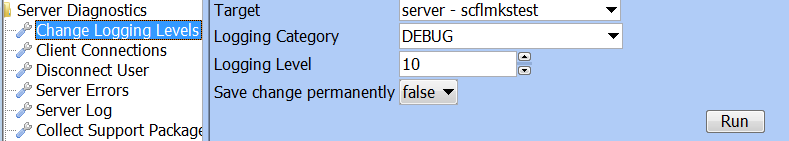

If you have the Admin Client and look under Server Diagnostics - Server Log
If you are not getting enough information you can change the logging to be higher
May 20, 2016 2:02 PM UTC
I think you misread the question, it has nothing to do with the level of details.
The question was how to get the full (or almost full) file if you don't have physical access to the server.
