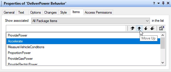

At the package level you can control the order items are displayed in the package's properties page (Items tab):

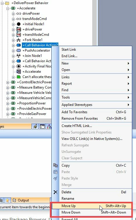

The above function is not available for items contained by an Activity but I am able to use the "Move up/down" functions on the right click menu to manually order items.
