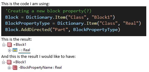

Hello PTC-Community,
does anyone have experience with creating SysML-Blocks via the Integrity Modeler Automation Interface? Whenever I try to create a Block Property I just get the UML alternative. Also, I did not find a way to specify the name of the newly created part yet. Support would be really appreciated!
Thank you and best regards
Max

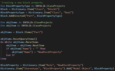

PatrickOllerton
Jan 20, 2022 8:16 AM UTC
AFAIK, there is no way to create SysML objects in one go with the API; it is necessary first to create the item, then add to the created item the blockproperty stereotype.
The relevant Help page is here:
https://support.ptc.com/help/modeler/r9.4/en/#page/Integrity_Modeler%2Fole%2FAddDirected.html%23wwID0E2AIID
regards,
Patrick
PatrickOllerton
regards,
Patrick
Jan 20, 2022 7:22 PM UTC
Hello Patrick,
thanks a lot, this really helped me out. For everyone facing a similar problem, this is the code I used to create a new SysML Block property called "NewBlockProperty" (Type Real) for the SysML Block "Block1":
