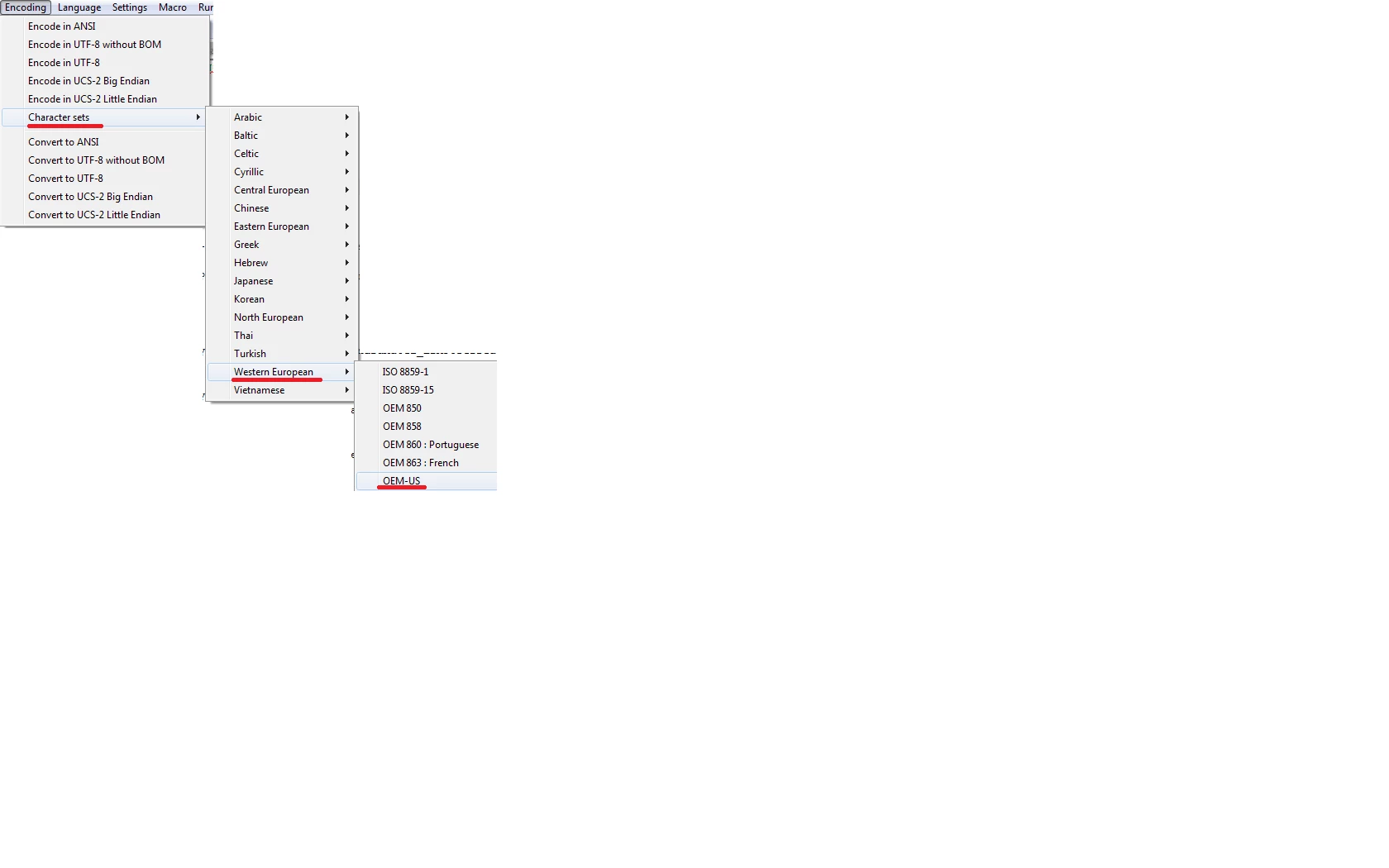

    Two conditions must be met
    1. Make sure the batch file is saved as OEM (see screen capture attached). This is very important!
    2. Make sure the code page set in the batch file matches that of the  characters being used for project and member names
    For German letters it is 850 so using chcp 850 works now fine.
