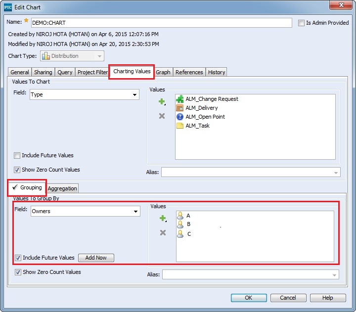

When I creates a chart which relies on a specific query, I have a problem that the grouping is not updating automatically when a new grouping/ member added in the query.
My expection is that the owner will update automatically every time when a new owner appears in the query.

    Hello Matthias,
    Suppose I have a query named as “ABC” and in this query the mentioned “owners” name is “AA”, “BB”, and “CC”. Now I am using this query for creating chart named as “XYZ” and mention the “Owners” name as “AA”, “BB”, and “CC” in the “Grouping” on “Charting Values” tab Please find the attached screenshot.
    Now I updated my existing query (ABC) and added a new owner named as “DD” and I try to run my chart (XYZ) but the new owner name is not updating in my chart as
    well as in the chart’s owner field.
    So could you please suggest me how can I see the updated query owners in the chart owners.

    Hello Niroj Hota,
    Did you post this question because you had the Include Future Values set in the grouping? I think if that was already set, then it should work. What happens if you click the Add Now button?
    This may be worth opening a case with PTC Integrity Workflow Management support.
