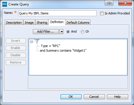

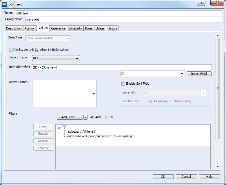

    May 26, 2015 4:35 PM UTC
    If the ID field is in the IBPL Item Identifier, you can see the backing ID (see below).
    However, if the ID field is not shown, you must query the backing item types instead. For example:

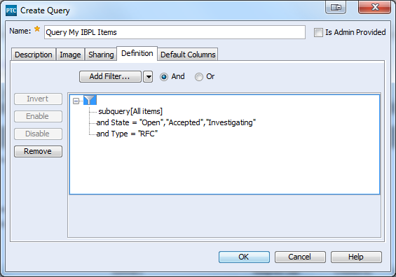

    May 26, 2015 7:00 PM UTC
    In my query screenshot above, it was not the best example. The query definition should really match the conditions of the IBPL filter and would look a bit different:
