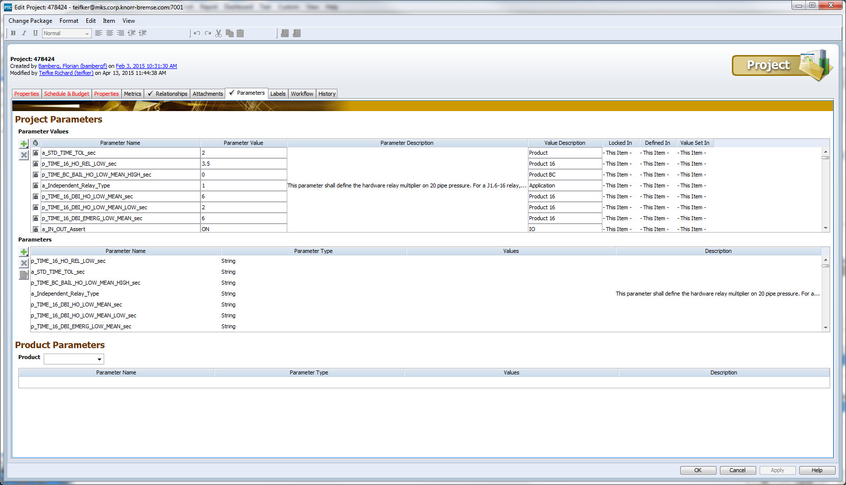

Can Project level parameters values be updated either through the java dll or command line inteface

    Thanks for the screenshot; that makes the question a lot clearer.
    You can edit the parameter values field using the "im editissue" command, but unfortunately, you have to provide the entire field contents for any updates.
    So using your screenshot above as an example, if you were to update the value for a parameter named a_FV, you would also need to include the definitions and values for all the other parameters. Like so:

    You can get the current value of the fields by running "im issues --fields=parameters,"parameter values" [Item ID].

    If you are referring to updating a Workflows and Documents project, then you can edit the project definition by using the "im editproject" command, or edit the project item by using the "im editissue" command. "im editproject" would be used to change information such as description, permitted groups and administrators. "im editissue" can be used to edit any field in the linked project item, assuming you have the correct permissions and the fields are editable. You can find more information on either command in the man pages. See KCS 154554 for more details on accessing man pages and command line usage information.
    rteifke1-VisitorAuthor
    Apr 14, 2015 3:36 PM UTC
    I am referring to the parameters defined here:
    I do not have documentation for "im editproject" and I used the command line which stated the server has been locked down since 2012? Should I be able to use ineditissue for updating these? if so can you provide and example if my parameter was a string named "a_FV"
    Apr 14, 2015 4:13 PM UTC
    There is a field called "Parameter Values". You might check that out.
